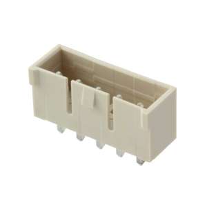

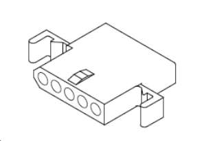

Here are photos of the older and newer connectors on the displays:
- Older connector on displays
- New connector on displays

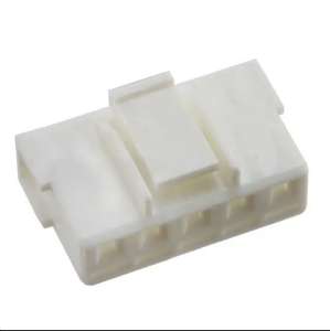

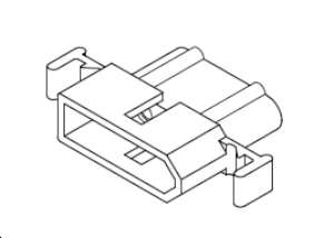

Photos of connectors on power cables:
- Older connector on power cables
- New connector on power cables
