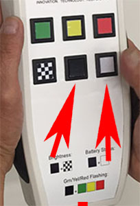

Best to determine the level of battery charge remaining before a race event starts, To do this, press and hold the black button, press and release the white button, then release the black button. The battery level is measured by the hand controller and sent to all the safety lights.
The safety lights display green if 100% to 50% of charge remains, display yellow if 50% to 20% charge remains, and display red if 20% to 0% charge remains. Lets say yellow displays and taking the worst case scenario, 20% battery charge remains. 170 hours x 20% = 34 hours of charge remains, of course, a busy track requiring a lot of safety light use will be less than the full 34 hours.
