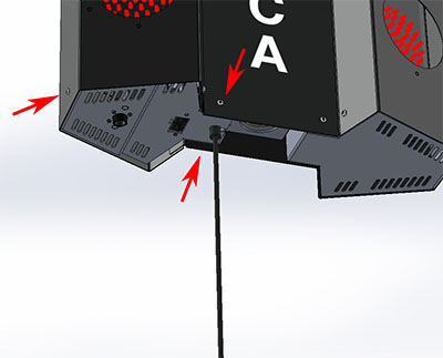

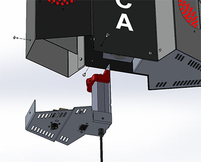

To remove the tree electronics from the tree, remove three screws holding the bottom plate of the tree in place as shown in Figures 1 and 2.
Figure 1
Figure 2
The four cables are grouped as two for the left side and two for the right side and indicated on the tree electronics circuit board between the connectors as LEFT or RIGHT. Unplug each of the connectors and mark them as 1 through 4 so they can be plugged back in where they came from when done troubleshooting.
